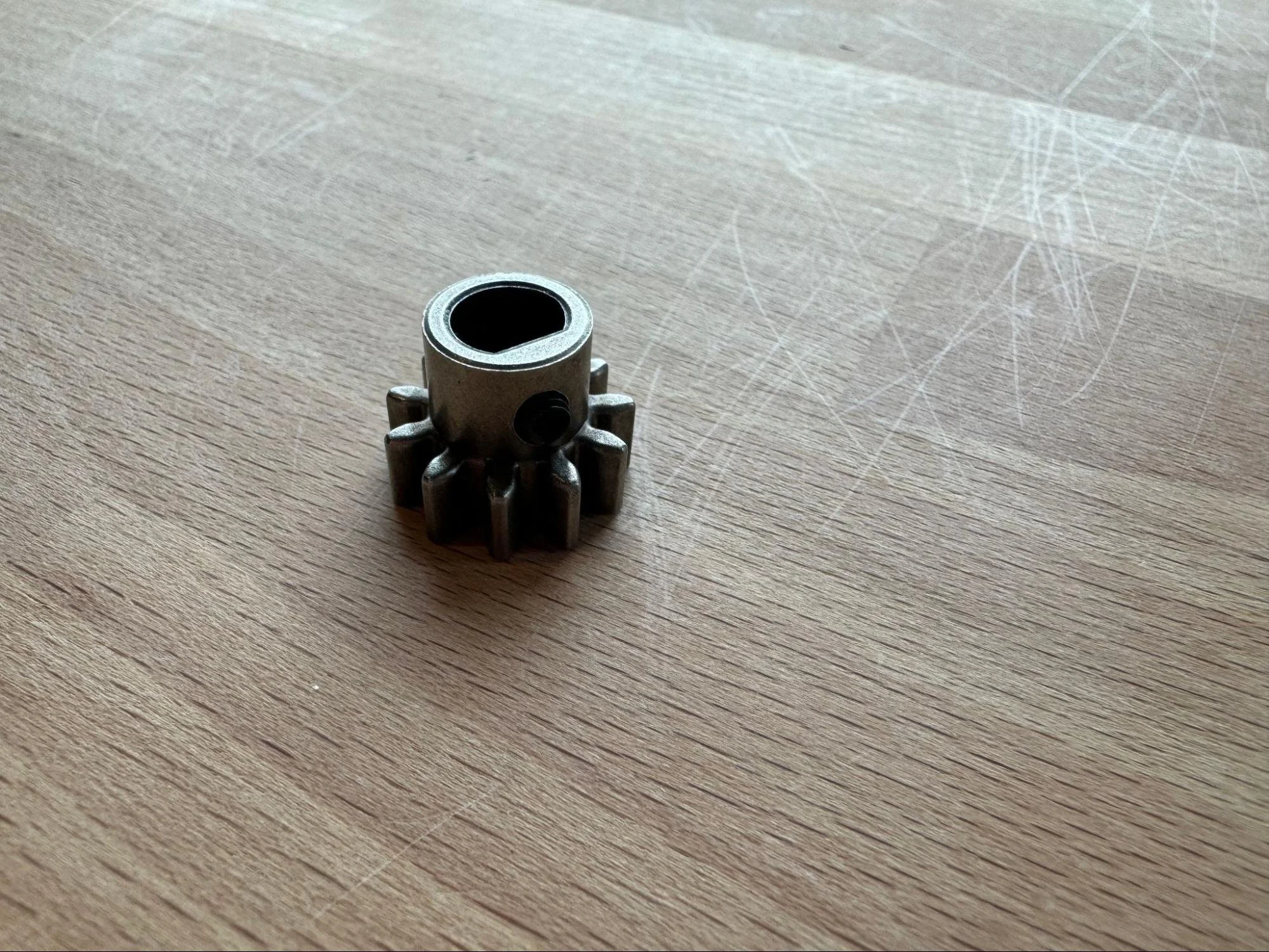

Next we need to collect our drive gear (which has a D shaped opening in the center) and set screw:
Thread the set screw part way into the drive gear:
Then attach it to the motor shaft. The gear should be almost but not quite touching the plastic or lifted up about the width of an index card or three pieces of paper. Tighten the set screw to lock it in place.
