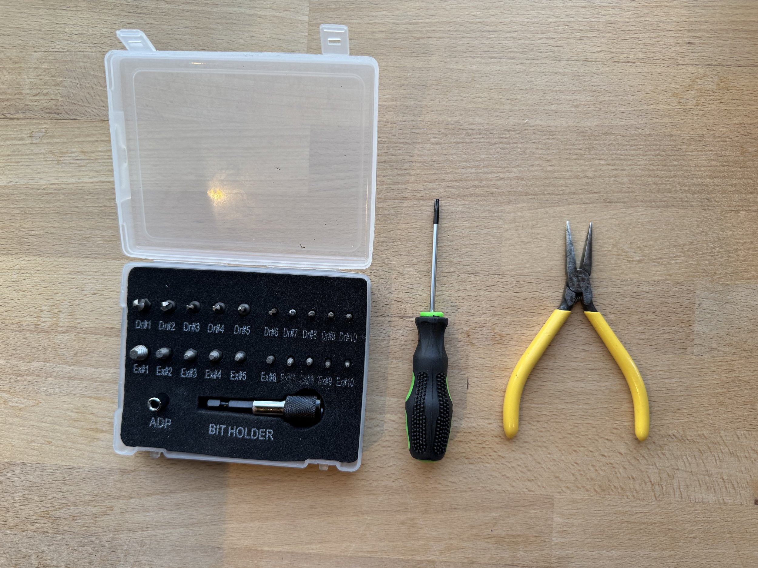

The changes in the Maslow 4.1 hardware upgrade touch many different parts of the machine…unfortunately that means we need to take a lot apart. Before getting started, here are some tools other than the included ones which you might find useful to have on hand. They include a small pair of pliers, a Torx T10 screwdriver, and a set of easy outs (I used this one) which make it easy to remove any stripped Allen bolts.

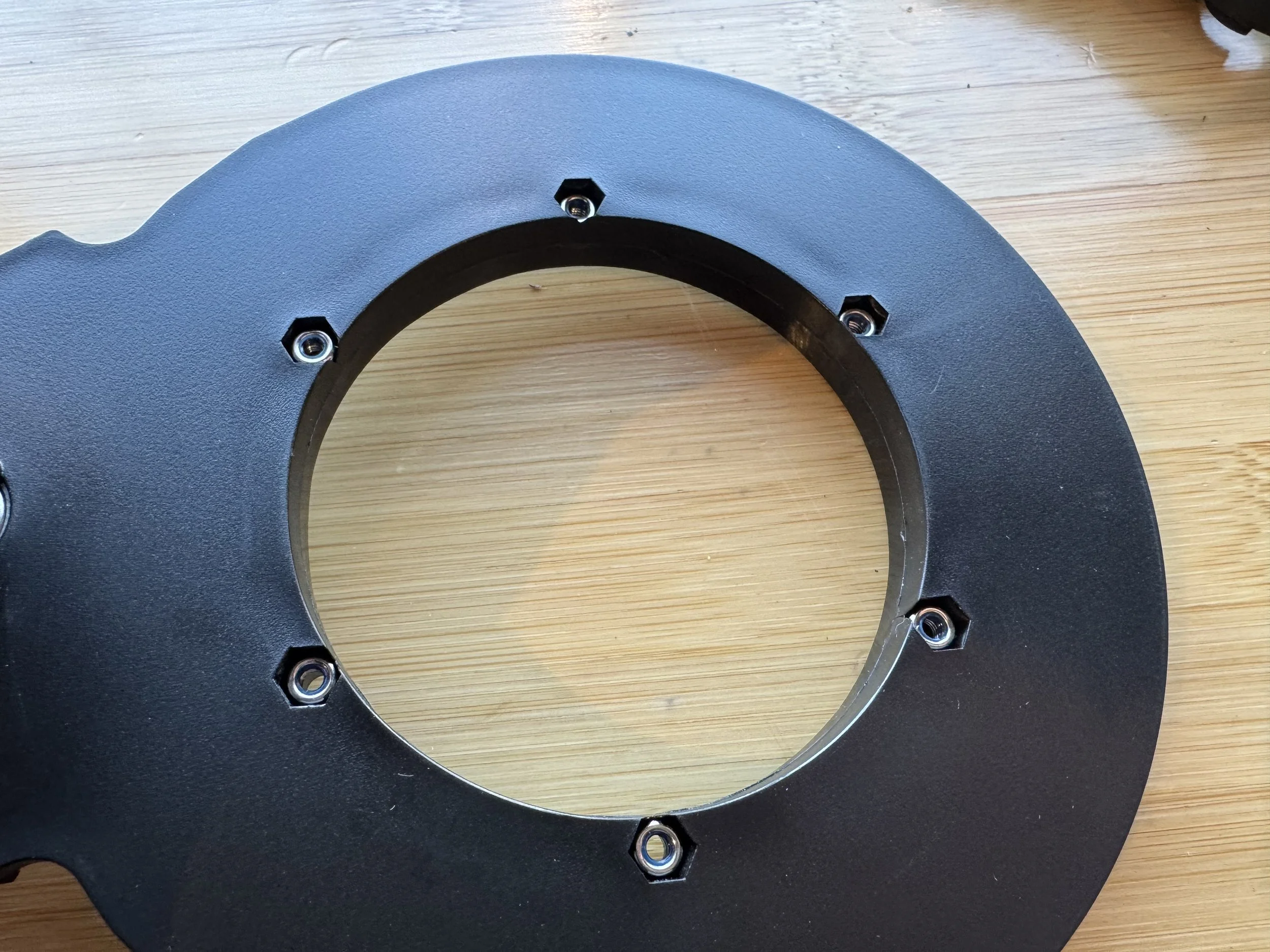

Then we need to repeat the same process on the other arm side with the lock nuts. Again, use a bolt to pull each nut into place, then remove the bolt.
Once all six nuts are in place the arm should look like this
