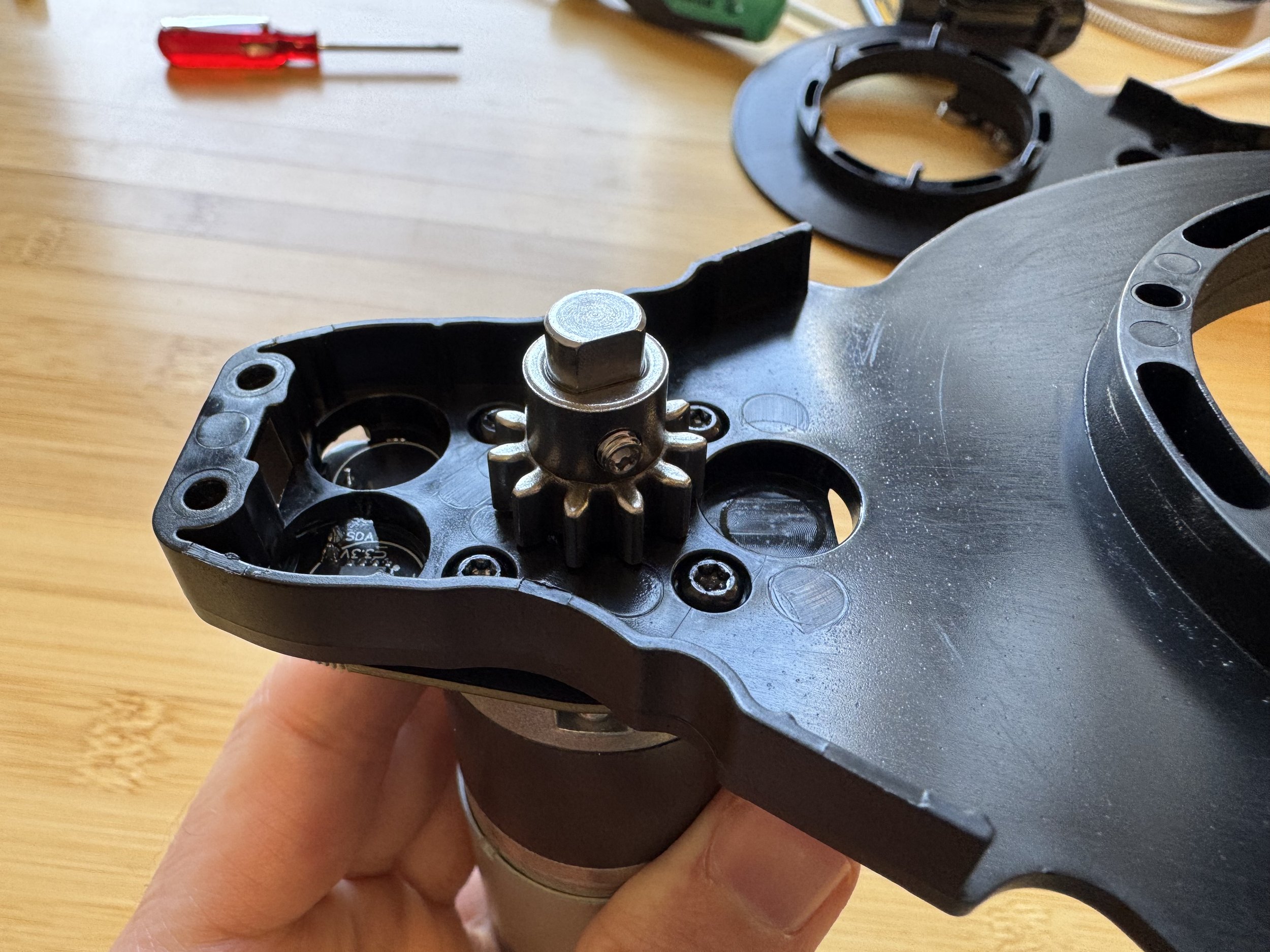

Next we need to collect our drive gear (which has a D shaped opening in the center) and set screw:
Thread the set screw part way into the drive gear:
Then attach it to the motor shaft. The gear should be almost but not quite touching the plastic or lifted up about the width of an index card or three pieces of paper. Tighten the set screw to lock it in place.

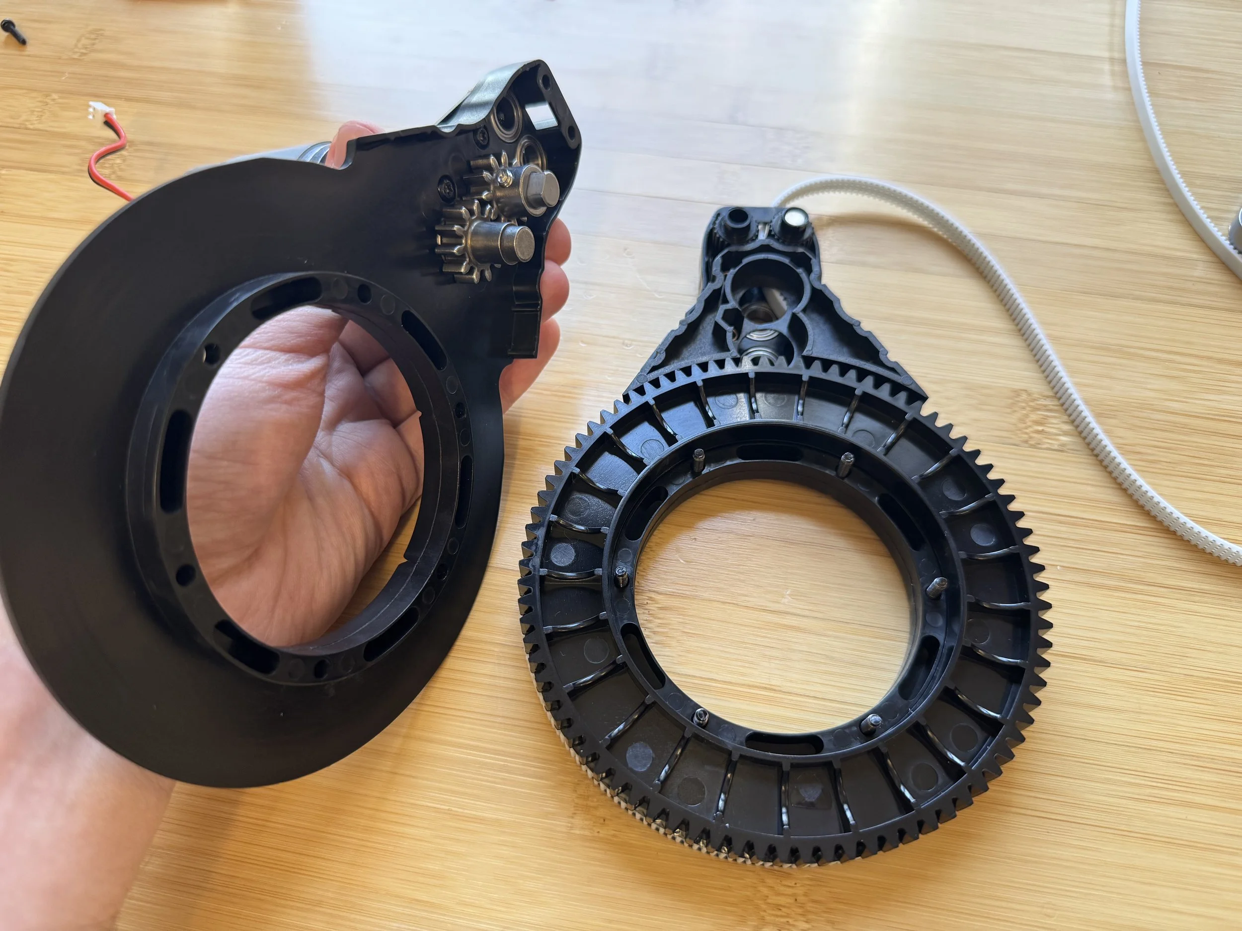

This next part where everything comes together sort of happens all at once and can be a little tricky. Don’t feel frustrated if it takes a couple of tries to get it right. With practice it can be pretty smooth, but the only way to get the hang of it is to try.
First place the spool with the belt wrapped around it onto the top of the arm so that it engages with the drive gears. The fit will be quite snug.
Note that when we route the belt we want it to pass in front of the drive gears, not behind them.
Next on the other side of the arm thread the end of the belt through the belt guard and insert the two rollers. Note that one roller has a magnet and the other does not. The placement of the magnet is very important. It must line up with the sensor (in green on the right) on the other half of the arm when the two halves come together.
Then press the two halves together. This is much easier said than done and this is the trickiest step of the build process.
Generally I start from the back of the arm (the side that doesn’t have the belt coming out of it) and work my way forward.
There are three things which will need to go into place. First the idler shaft needs to align with the hole on the opposite side. Then the drive shaft needs to align with the opening in the bearing on the bottom, then the rollers will need to line up with bearings on the other half.
I find that by checking each one of these locations in turn and getting them lined up the two halves will come together. It can be helpful to use the allen wrench to jostle the rollers around to make them line up.
Then we join the two halves together with eight bolts.
Two of the bolts at the front already connect to the captive nuts there. If those nuts are out of place, I find the Allen wrench works well to jostle them back into the right position.
The other six go around the center of the spool. The direction of these bolts can go in either direction. Don’t over tighten these, they just need to be tight enough to keep the two halves together.
