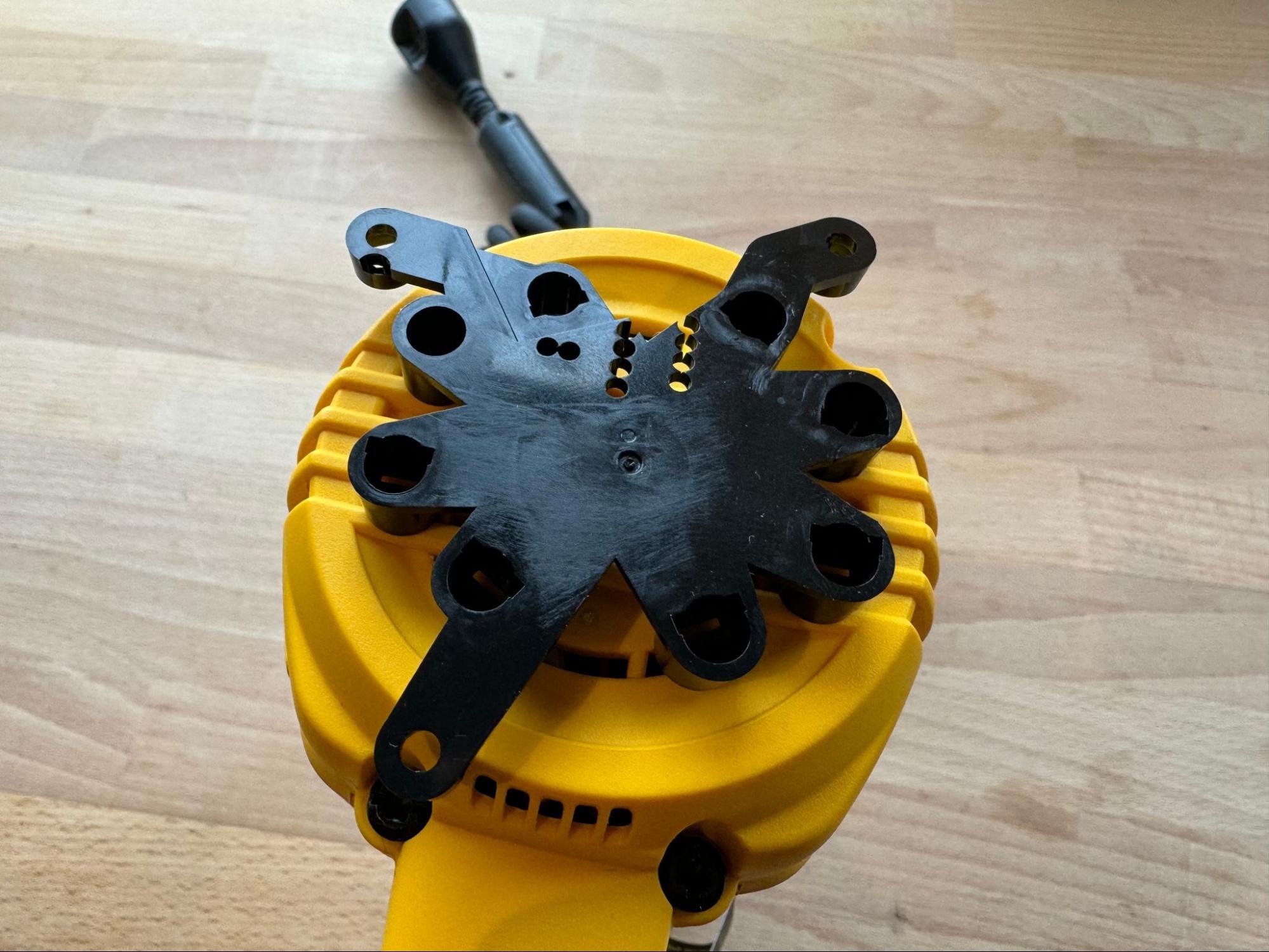

Attach the PCB mounting plate to the top of the router. The orientation of this part is important so be sure that it’s not rotated 180 degrees. The power cord is down in this photo. Use a firm slap or a tap on the table to press it in place.
Note that this part has been reported to fit not quite right on the 240 volt version of the router. See a potential modification to this part here.

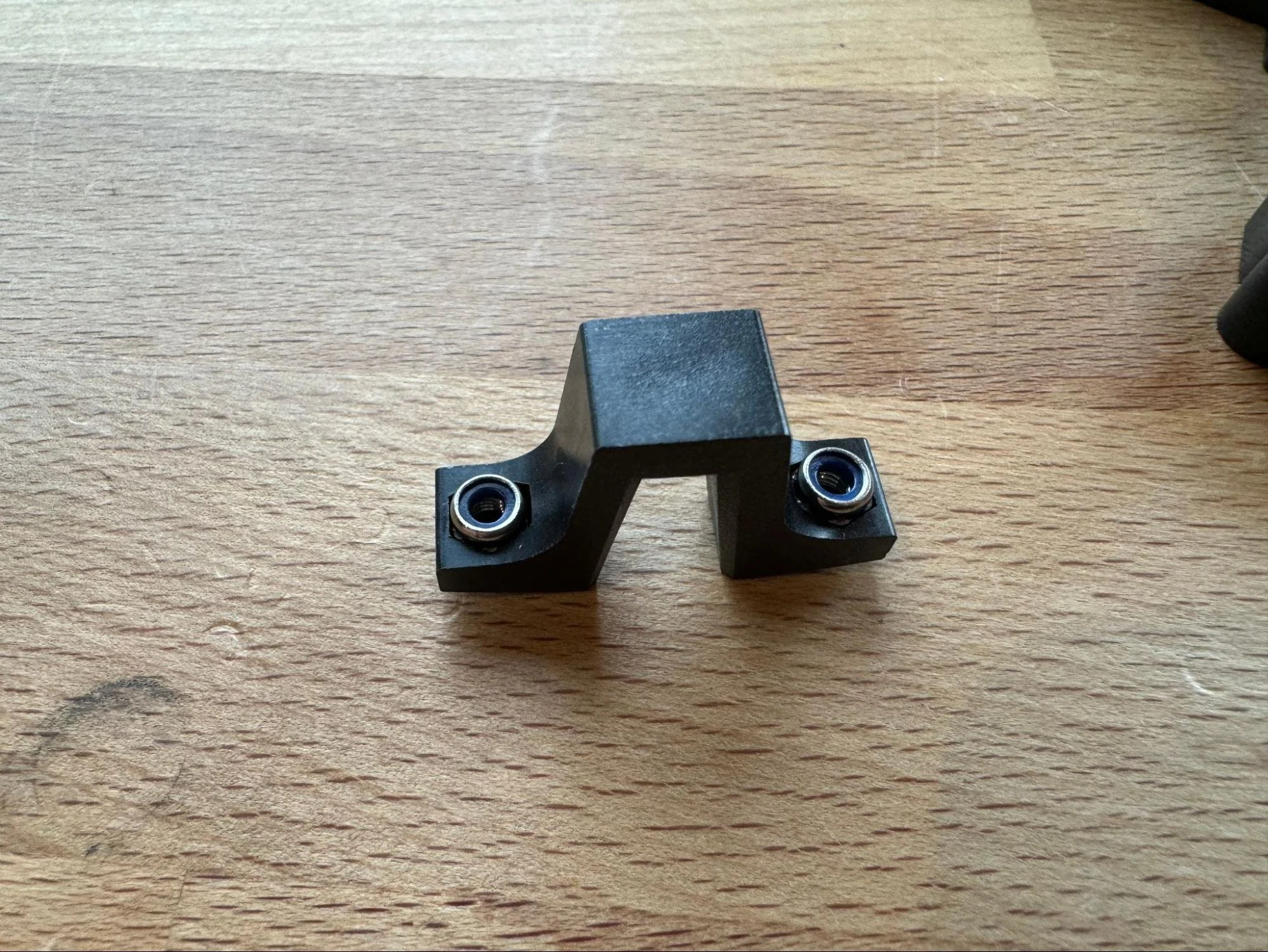

Next collect the linear bearings and two of the uprights.
Press a linear bearing into each end of those two uprights.

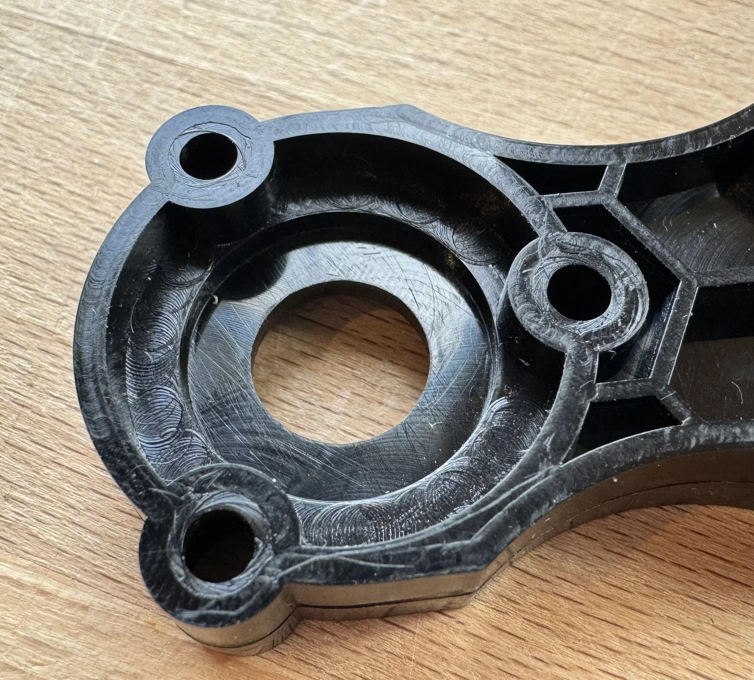

Next, we will bolt the uprights to the clamp. The uprights with the linear bearings will fit into recesses on two of the arms (shown on the right).
Note that the two uprights with the linear bearings go to the left and right of the power cord, while the two without linear bearings go close to the power cord and across from it.
Each upright is held in place with three bolts.

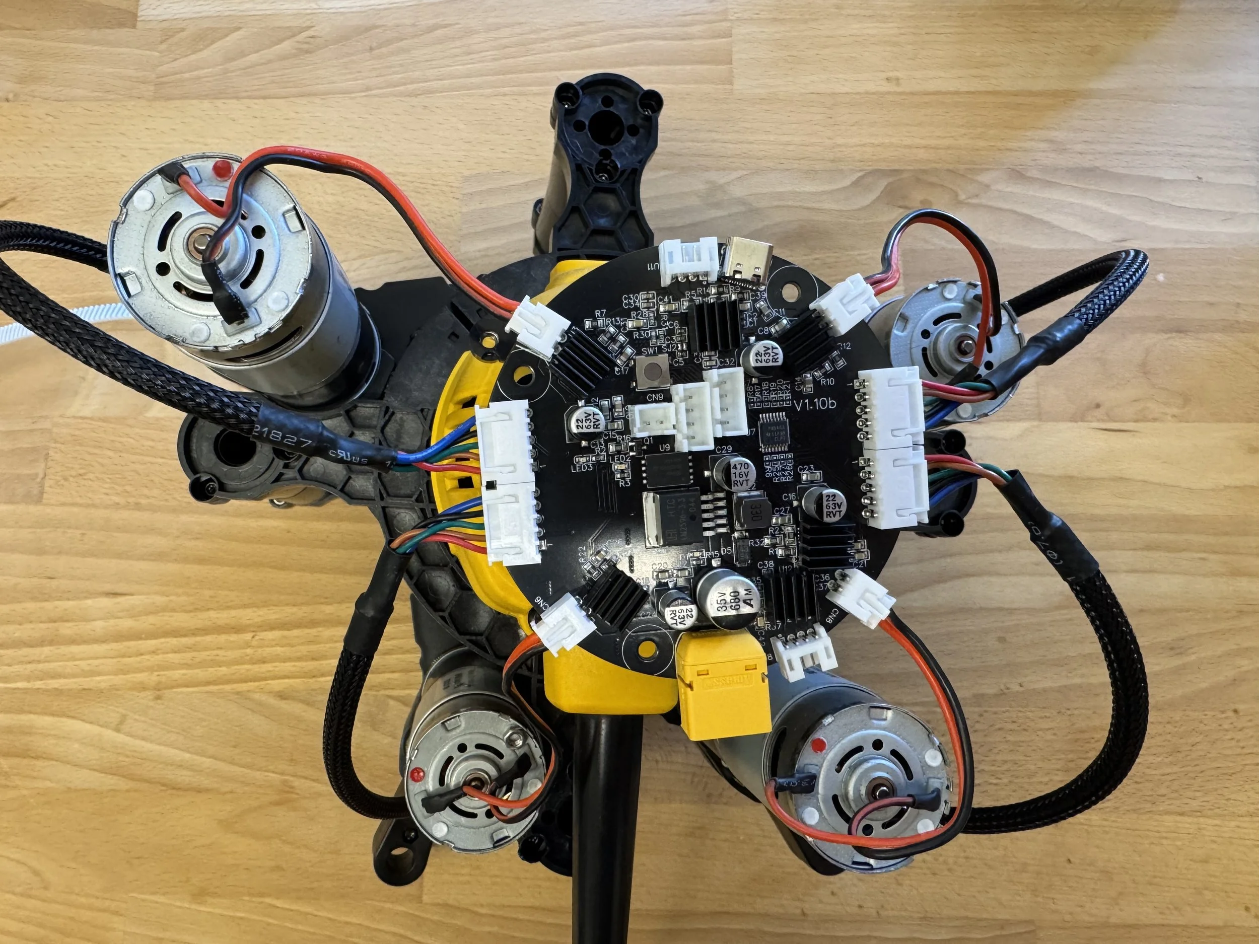

Place the main controller board on top of the router and plug in the four motors.
Quick edit here. I will need to re-photograph the rest of this section, but until I have a chance to, the six heatsinks are attached to the tops of these six chips.
Use the four ethernet cables to connect the encoders to the controller board.
