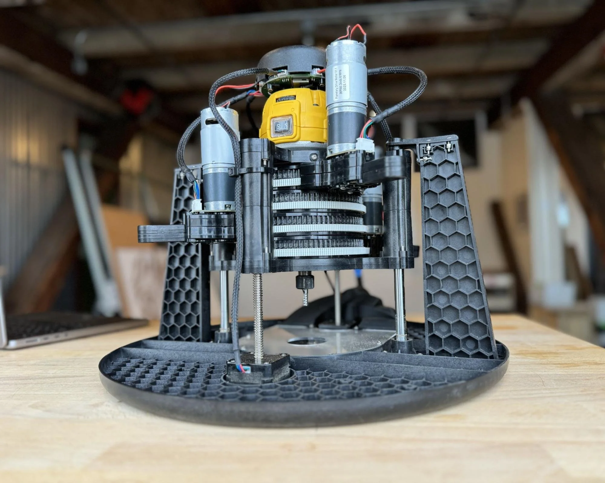

First off, we are thrilled to announce that we are launching a 2nd Kickstarter campaign for Maslow4.1. This Kickstarter aims to get Maslow kits in the hands of everyone that missed our last Kickstarter and also provide an opportunity for all of our existing Maslow4 users to incorporate the upgrades into their machine.
If you have been following our project over the past 6 months you know that we are constantly working to improve Maslow4 with the help of our fantastic community. Thanks to your feedback we have been able to continue to improve the user experience through both hardware and software updates.
With your help, we can order new molds for the updated mechanical parts and meet minimum order quantities to begin production of the 4.1. In the coming weeks we will post our kickstarter video to our youtube page with more details and then begin the campaign. We will email everyone on our waitlist when we go live! We couldn’t be more excited about all the progress that we’ve made and we’re excited for the future.
