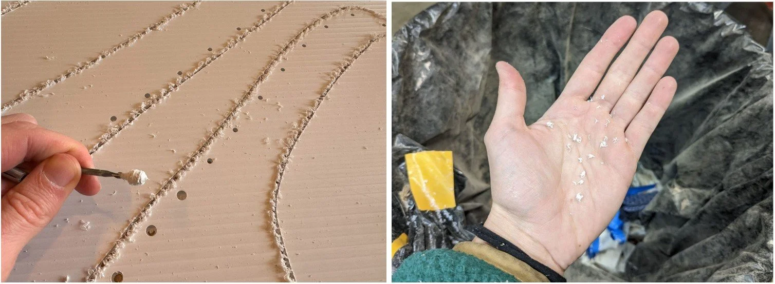

Though we were originally intending to post this project for Halloween (how cool would that have been?), the Kickstarter release soon took precedence. Nevertheless, we want to showcase this project because it was an experiment in unconventional CNC materials. It’s made of coroplast, i.e. corrugated plastic, and zip ties. The video will go into more detail on what we discovered while working with the coroplast and the Maslow, but overall we deemed it a great success.
While working with wood is certainly the Maslow’s bread and butter, it was great to see that it works well in another medium. As we have seen in the forums and in the update above, some Maslow users have fitted their machines with pencils or markers in order to draw with the Maslow, and someone even wants to try to cut cloth! Actually the drag knife above would be perfect for cutting coroplast. Whenever we experiment with a new material we will be sure to let you know how it goes.
