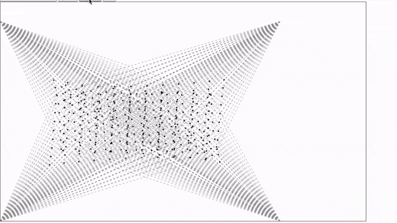

We found that the calibration process could sometimes take a REALLY long time to conclude. The way it works is that it decides it has found the optimal locations of the anchor points when the results stop improving…the problem is that for some sets of measurements the results might keep improving by a tiny fraction of a mm for a long long time. The calibration process now automatically terminates after 200,000 cycles which is more than enough. While working on this bug we made numerous other improvements and fixes to the calibration process which should lay the groundwork for future developments like having a user defined calibration grid, and real time visualization of the calibration process.
The calibration algorithm finding the correct locations for the anchor points in real time
