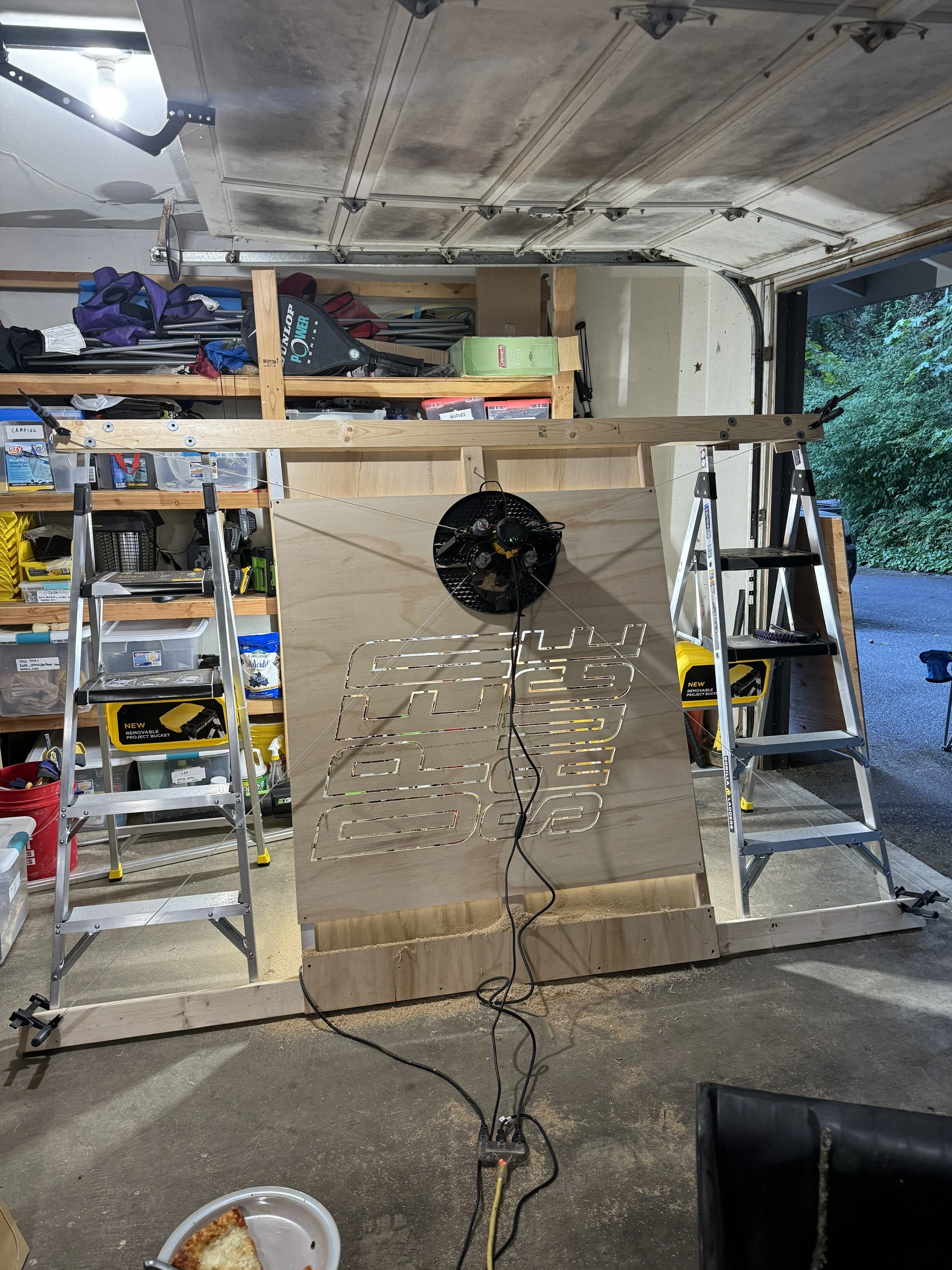

We applied to take Maslow to Open Sauce this year, but we didn't get accepted...well technically we got invited to be a corporate sponsor, but we absolutely can't remotely afford that so we resigned ourselves to not going. Then forums member @Azab2c who is here in Seattle also reached out to let us know that he is going along with some of his projects and asked if we would help him get his Maslow in shape to show.
He had a really cool idea to build the frame using some aluminum ladders to make it collapsible which worked out great. It's not a full size frame, but for demonstration purposes it's great. We also got to test out the idea of using C clamps as the anchor points and that also worked quite well.
It's super fun to have an excuse to try new things and push the envelope. We decided to cut some signs that says “Open Sauce”. He’s leaving later tonight so it had to happen NOW.

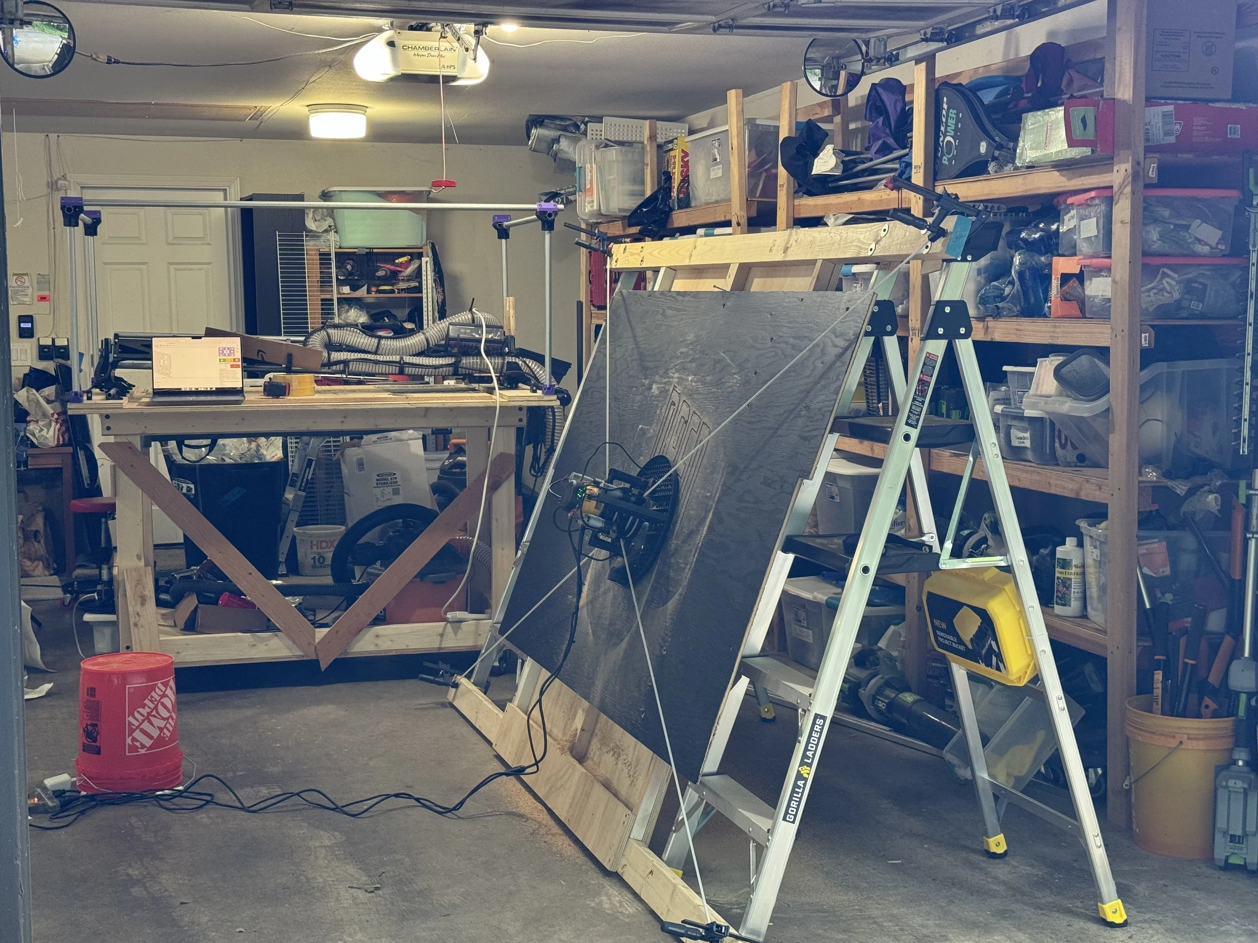

We started cutting the sign and BOOM right away get the error we've been tracking down where the ESP crashed, we didn't even make it half way through the O in “Open Sauce”
I’m like **** this didn’t used to happen…how can I fix this issue in the next hour? Then it hits me…this didn’t used to happen! If it didn't used to happen then what's changed? The firmware version! I thought maybe going back to an earlier version could fix it so I jumped all the way back to firmware version 0.64 and everything cut normally.
Does that mean that you should go back to 0.64 if you are having that issue? No. 0.64 is horrible. We’ve made so many improvements since then.
What it does mean is that we (being Anna and I) need to go through and test each firmware version to figure out where the issue started appearing and then track down why. It might take us a little bit, but we’re on it! It feels good to be making progress on tracking down where that issue came from and we couldn't have done it without @Azab2c giving us an excuse to try something new and step out of our comfort zone.

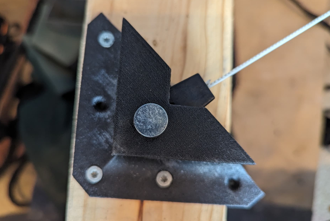

Forums user @E_L_P took the initiative to improve the 3D printing file for the corner anchor point. They changed the orientation of the part so that it doesn’t need supports while printing and improved the countersink for the screws. Great work!

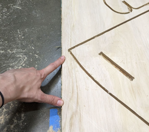

Anna has been running tests at ALTSpace and was able to cut super close to the edge of the plywood, about 2 cm, without the sled tipping.
