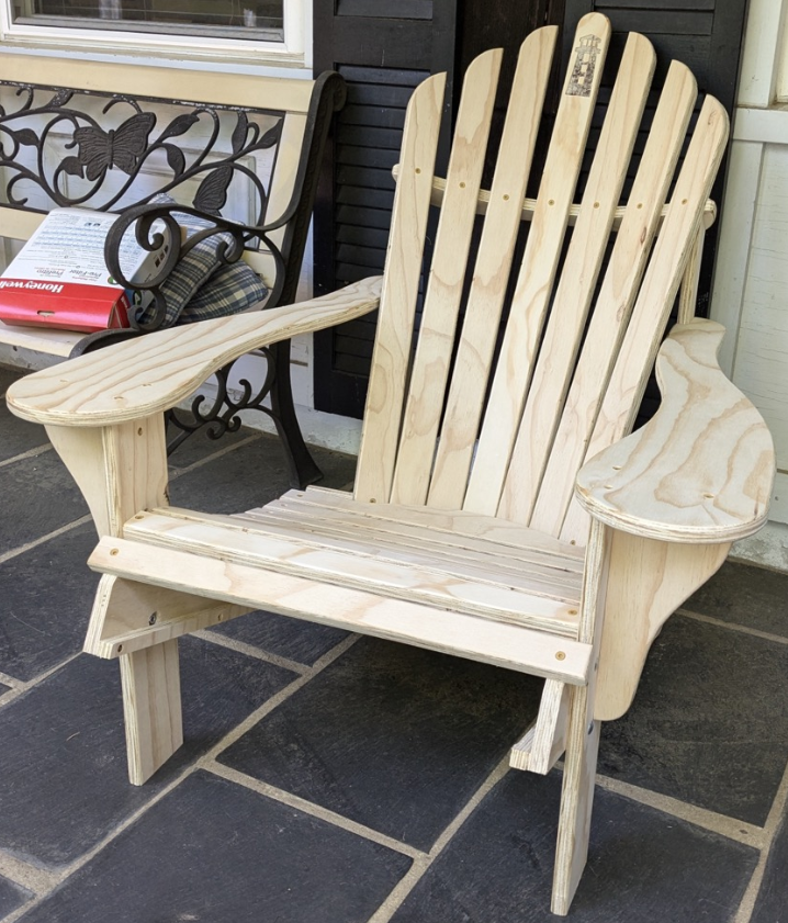

@tryon also made some Adirondack chairs, which he cut out of one single sheet of plywood!
