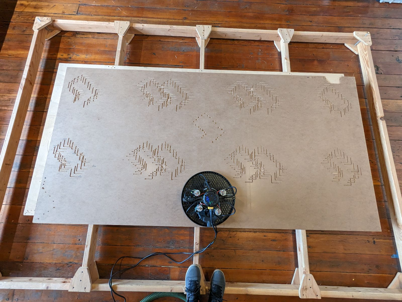

As mentioned in last week’s update, we are currently running some experiments on the calibration process in order to improve the machine’s accuracy and eliminate any human error during the calibration.
This is a time consuming process, and we’re stoked that we finally have the time to do it. So far we haven’t found anything groundbreaking, but we’re getting a better understanding of which factors in the calibration process are important and in which ways.
Running these tests involve running the calibration process over and over followed by cutting the same test pattern over and over.
The test procedure generally goes like this:
1- Turn on
2- Change the variable we are testing
3- Retract, extend, run calibration
4- Raise z axis and insert the router bit
5- Set z home
6- Turn on router and begin cut of the test box file
7- Complete cut and raise Z up to 40ish
8- Remove belts from anchors and retract all
9- Remove bit and lower Z all the way down
10- Measure boxes for accuracy and enter the data in the spreadsheet
11- Reposition cutting surface slightly
12- Turn off
The file we are using consists of the corners of 4 boxes, measuring 600mm x 600mm. These boxes are intentionally large, so that any error that accumulates as the machine moves is apparent when we go to measure. We also wanted to make sure we were getting data from different quadrants of the cutting area, so just one box isn't enough. The more data, the better.
Some factors that we are exploring are:
The number of points in the calibration grid (3x3, 5x5, 7x7, 9x9)
The size of the calibration grid in mm
The spacing between the belt teeth…is it exactly 2mm?
The extra length contributed by the belt end and the arm…do we have that measurement exactly correct.
Testing is still in progress, so we don't have any results to report yet. Hopefully we will have some conclusions next week and any improvements that we are able to make will be included in future firmware updates.
